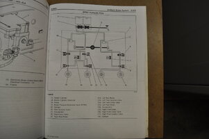

Here is a schematic of the entire brake hydraulic system including the internals of the ABS module. By exercising certain solenoids (items 11, 12, 16, 17 front brakes, and 6, 8 rear brakes) a firm pedal can be obtained.
