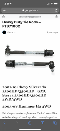

Ive seen other users go with the fabtech 2500hd or mevotech inners and outers, but im afraid those wont fit mine because its a 14mm
What do u guys think of the fabtech setups? And i posted more pics of my tie rod ends left and right , the problem occured with the right outer tie rod end.

Okay I totally agreee and thanks for the help man. Can i ask, what tie rods inner and outer have you put in?

I have not replaced my inners yet, mine are still factory originals. My outers I just recently replaced with Detroit Axle...
But for your situation, I would not recommend them. You are going to want to find a parts warehouse local, that has both the large diameter, and small diameter in stock. Go buy both. When it goes into the knuckle right, it will look like the pic above. Just enough threads to put a nut on, and maybe a couple more, but not enough for 2 nuts, plus threads.
Then you can make the decision to stick with those, or maybe find "quality parts".
I quote the quality parts, because I dont think it really matters what the brand name is, except the high end mevotechs, I would bet they all come out of the same factory. Find one with a greaseable fitting, lifetime warranty, and go with it.
