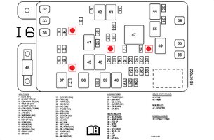

(1) Visit the Under-Hood Fuse Box and check the "Tightness" of the Four (4) Galvanized Post Bolts that hold the lower Harness Plugs. It would not hurt to Spray out both sides with CRC Electric Spray Solvent and let them all Air Dry before re-attaching and *Snugging* the sections back together:
