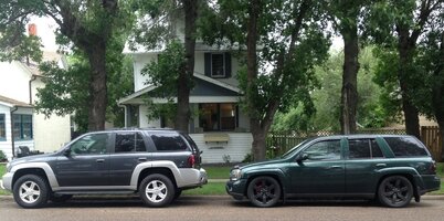

I wanted to wash and detail and stage them somewhere cool but that just isn't going to happen so here they are finished...for now. The green one is so low the splash guards scrape speed bumps! That takes me back to my youth...
