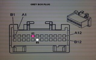

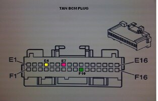

So for my Quad beam headlights:
The pink/white wire pin A4 in connector C1(gray) at the bcm controls the low beams
The black/white wire pin A5 in same connector controls the highs. I added a diode between the 2. So that when the highs are on power flows through the diode to turn on the lows, but can't flow from the lows to turn on the highs. Simple
To install it I removed the Terminal Position Assurance (TPA) comb installed the diode, then tested. Found I had it backwards(so quad lows and 2 light highs:duh:) turned it around recheck ok. Reinstalled TPA. I have the leads on the diode so short that it is tucked inside the connector and you have to look for it to see it.
For the DRLs
I used the capicitor mod. I spliced in a cap with one end on the pink/white wire and the other on Ground. This allows the lows to function as DRLs at 100% brightness. It also retains perimeter lighting. IIRC it was a 10uF cap. (it's under the tape on the gray wire in the pic)
The reason I did these mods was so I could run HIDs. Because the DRLs and perminter lighting run at 70% pulse width modulation(PWM). Meaning that the light is on 70% of the time and off 30% in a short time window like on the 1/10 or 1/100 of a second range. But these pulses not only lower the RMS voltage but it also kills HID ballasts. I am guessing that the power occultation is a factor not just the low voltage.

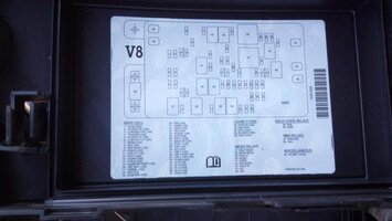

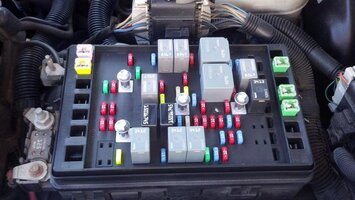

Don said:
I have a 370, and no relay in the front. :(
You should. Take your front fuse block cover, and look on the inside of it. It should give you a layout and assignments for the different relays and fuses. :book:
Edit: #46 Should be labelled "Headlamp Driver Module"
I will get pics tomorrow.

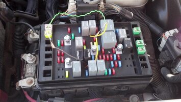

Don said:
Can I get pics or a schematic of this? I looked and looked for a low beam relay to no avail in my fuse box,
Just a note (if you didn't get it from the photos): the poster and article writer are talking about the fuse box under the hood, not the fuse block under the dash.
Figured I'd open my mouth so folks know I'm still here
Ok, #46 is the solid state relay. I think I was a bit confused by the pic that it was using the headlight washer relay for some odd reason. I got it done and also cleaned it up a bit when I soldered everything up, Thanks.
