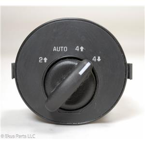

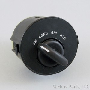

02-05 4WD look like this:
06+ 4wd look like this:
Picture.aspx
My daughters 02 doesnt look like that, its 2HI, AWD, 4HI, 4LO
I'll have her send me a pic, lol. I used to always be confused why it said AWD

The part time AWD system as well as the A4WD setting on the 4x4 is lame compared to full time AWD. I call it the "slip/bang" system. Rear wheels slip and it bangs in the front wheels, which is likely the reason for stripped intermediate shafts. That's why we don't recommend to use the A4WD setting. If you need 4x4, use it. Not much we can do with the AWD system. it's just there unless it's disabled.
ok yeah that is her same dial lol.
