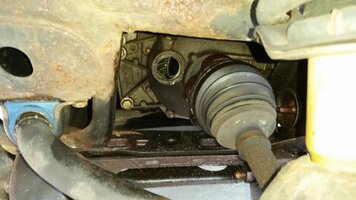

Hey guys, so yesterday I noticed my truck started making drip marks in the street, like bad and everyday. First I thought it was motor oil, but then I thought maybe power steering line or something else. Long story short I pulled the drivers side tire to find this:
Fill level more then an inch below the fill plug
After I came back from a drive, been sitting there for about an hour. (Yes it was a clean spot.)
So I am going to hose it with parts cleaner, dry it and look to see where it is coming from. It is sprayed all over everything but appears to be the axle seal, which would explain why its all over everything. It appears to originate from that block thing with the sticker, I guess its part of the cv or axle or something.
That "block thing" is the inner part of the CV axle. That axle seal is not too bad of a job to do. Used to be a dealer only item but SKF makes a replacement one now you can get from Rock Auto for 12-ish bucks IIRC.

I can't even fathom how this seal comes out. It was defiently the culprit though.

So, I have it out. I'm guessing that little ring in the middle, a race I suppose, is supposed to fit snugly and not have tons of play? Also, on the back there is a metal clip with points that looks like it mates with a similar looking clip in the actual diff. Correct me if I'm wrong.
New seal will have all the tabs sticking out, when you put it in place several will flatten and others will lock into the diff which locks the preload. Don't turn that thing in there.
The CV wont' be overly snug going into the seal but it shouldn't be floppy.

To that little piece isn't supposed to have any movement either right? The knurled inner race thing. [emoji13] Mine moved around in every direction.
Uhhhh no lol. It is supposed to stay in place, that's how it seals. No wonder yours is leaking! I'll bet it isn't leaking between the axle and the seal, but rather straight through the seal lol.
Kinda what I suspected. The whole outside of that seal was covered in gear lube, so I imagine it was the source.
