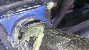

I was wondering if anyone has a picture of the front sway bar bushing and if there is any gap from the bushing to the bar.
There is a pretty big gap "from what I would consider" on my front bushing the rear is a perfect tight no gap fit. The bushings that used to be there were 34mm the replacement moogs are the same size. And I still have a clunk in the front since these bushings aren't tight enough
So are these just bad bushings or what?
The hole in the bushing should be the same size as the diameter of the sway bar. It should be a tight fit. Have you measured the sway bar.

Yea, I wrapped a paper around cut it and divided by pie. I got 1.42 iirc so I was obviously off, this was the 36mm bushing. I'll take a pic of the 34mm bushing on it today uploadfromtaptalk1433856455599.JPG

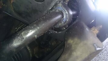

I have already replaced both front sway bar links with moogs and the bar doesn't move, before I was able to push the bar and make it clunk, now i only get the clunk when driving
Passenger side
No gap on the other side
Driver side
uploadfromtaptalk1433861308663.jpeguploadfromtaptalk1433861316848.jpeguploadfromtaptalk1433861332255.jpeg
Once again no gap on the other side
it's hard to see through all that grease but so what your saying you did was you first installed 36mm and realized they where to big so you've swapped to 34mm and still getting a clunk? there is a some deformation on the outside of the bushings because of the curve in the bar, at least thats how mine was, as long as the bushing clamped down tight it should be good, 34 and 36 are the only sizes listed for your year on rockauto. double check your Moog endlinks, I had the bolt on one of the rears of my moogs back off a little and started clunking like a bad endlink, you got to really torque them down.
Yes, also I did actually torque them down but since I have the car up I'll check them again.

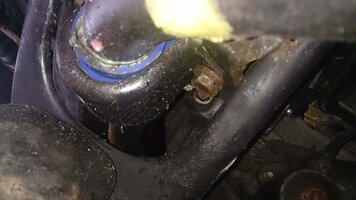

Also here's a pic if the passenger side lifted up
Driver Side
Passenger side
Driver side
Those look like the Raybestos blue bushings. I had the same problem a couple of years after I used the same ones on my EXT, which has the large bar. I think their rubber is just too soft. I'd just replace them with regular black rubber like Moogs.
They are moogs, also it never says it anywhere but as far as I know they are poly bushings. And yes the rubber feels softer and was easier to open then the rear moogs I got.

New acdelco's installed, a good bit less gap
