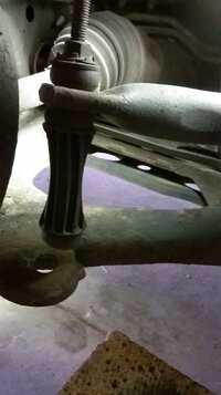

Been replacing my end links about every month or so, one will break usually shearing off one side and leaving the stud still in the mount. Luckily I am running the Napa premium part so I get a free replacement but am getting tired of the hassle. Last month I installed new proper size sway bar bushings and new end links. Yesterday backing out of the driveway WHACK! I knew one broke so looked and yup it was the passenger side this time. Anyways Id like to know any thing I should look into? And I'm not driving it that hard guys lol I usually have my 10 month old daughter with me. Its the 2007 Envoy Denali 4x4 Bilstein shocks with new mounts 1.5 years ago. it rides straight but my Napa guy suggested an alignment?

These solved that similar issues for me Although the other 2 sets I installed before these didn't break they just stripped the nut through or the bushing feel apart.

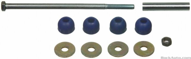

Does anyone have a part number(s) for the Sway bar end links (the straight ones)? I was putting on new rotors and brakes on my 2008 Saab 9-7x 5.3i yesterday and noticed the passenger side end link was broken at the bottom. Online all I see are the offset ones like my 05 Rainier had.
You can always just walk into autozone, pepboys or napa and grab the ones I have. My brother-in-laws tbss broke in the same spot and we replaced with the same ones I've got on my 08 and so far so good on both trucks. Sorry I don't have a part # but you'd just need to measure the length of the inner portion and they would give you what you need.
@Mike w they don't have the 08/09 style of front end links from what I'm going off of on the pictures and discription.
EDIT...If there is something better out there to replace what I have now I would of already had them on my Voy.
Well, I've found some more options: MEVOTECH Supreme MK 6629 $4.92 each and MOOG K6629 so far Rockauto with shipping is the cheapest.. still checking
