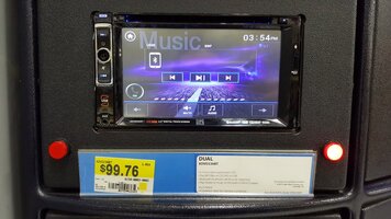

Whats the connector on ebay? i have XM, onstar 4 speakers no bose oe amp, no sterring wheel controls. just a basic oem stereo. looking to buy walmarts Dual Double din stereo XDVD256BT & Double din harness with the scosche interface (dont know which interface to buy). i want to keep the on/off with ignition, chimes/warnings & off when door opens.
