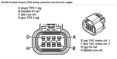

Before shelling out for replacement parts, rule out the easy stuff first. Throttle bodies are pretty robust--they do fail (albeit it very rarely) but it's usually a mechanical problem like jamming or the sensor circuits going. Neither of these match your symptoms and you'd have different DTCs.
My money is still on a problem with the wires at the throttle body connector or the connector/terminals themselves. The yellow and brown wires are the TAC control lines so pay particular attention to those when you're inspecting for damage or broken wires. Keep in mind that the copper wire may be broken inside otherwise intact insulation or under the weatherproofing grommet. Even removing and reseating the connector is often enough to reestablish contact if it's just corrosion on the terminals.

I think I figured it out today after it died again and I couldn't get it to restart and run properly without just staying in limp mode. I unplugged the wire connector going into the throttle body and plugged it back in and it started and ran fine. I'm having a hell of a time getting it to plug back in all the way. It's stopping short of the black clip locking itself into place no matter what I try. I removed the green rubber gasket from the plug and it still won't go all the way in. The male connectors aren't bent, everything looks like it should go together perfectly.
Any ideas?
Should the end of the wire plug casing go right up against the aluminum part of the throttle body or should there be about an eight of an inch gap?
The "Raspberry" colored center pin guide of the Throttle Body Metripac Connector can occasionally pull loose from the connector body where it should be seated flush, just below the outer edge of the plastic connector body. It might need to be removed to check the pin sheaths alignments underneath and then re-inserted. This image shows a good oblique angle to check against the way yours presently appears:
I just took a look at the connector and it is just below the outer edge of the connector body. I tried to force it a little deeper but I don't think it moved. I did manage to just barely get it to click but still might not be all the way. I'll just stop by a shop sometime when I'm driving around again and see what they say. Thanks for the help.
