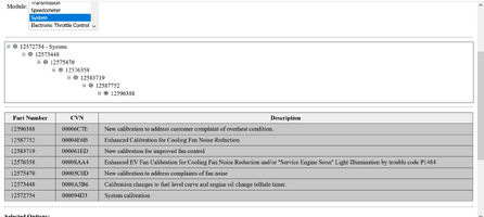

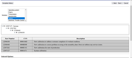

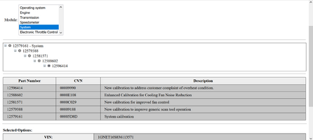

At a computer now. Found these for 02-03 and 04. 05 had no update.
04 is especially interesting as it addresses an overheat condition.

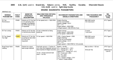

A couple things here with this code setting bother me.
If this document from a GM website is correct the code cannot set if the engine rpm is greater than 3200 rpm, and the fan has to be over 1600 rpm for like 100 seconds while it is not commanded on. (800/1000 cts @ 125ms per count).

I checked my manual for the Envoy, I have the paper manual for 2005.
If does not have the same specs for this code, your screenshot is for light duty trucks and I guess they are different.
Specifically, my manual does not have the condition that the RPM be between 1200 and 3200.
The more variations I see in "service information" the less trust I have that there even exists accurate information! Everything gets farmed out these days and accuracy suffers.
Here is where I got the document from which the screenshot came...

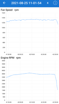

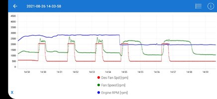

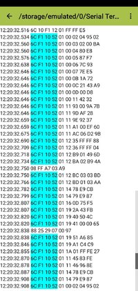

So I just came back from an errand during which I recorded a series of events where I used one phone to command the fan to 50% for 20 seconds while a second phone recorded engine rpm, fan desired rpm, and fan actual rpm. Here is a snippet from that recording. Interesting how much more responsive the fan disengagement is at higher engine rpm. I knew it is pretty much required that the engine rpm needs to be at least as high as 2000 rpm but I was not aware of how much quicker the clutch disengages at closer to 3000 rpm. This is a Upull Behr unit.image.jpg
If I've cleared the code with the phone, does that clear the freeze frame data as well?
I think yes, freeze frame data would be cleared with a code clear.
If you can capture the freeze frame it may offer a glimpse but then again might not.
I just happen to have a capture of mode 12 freeze frame data for a P0495 code. The "04 95" can be seen near the end of the second and last lines.
I do not know if the mode 02 freeze frame captures the same data. Mode 12 is what the Tech 2 displays.You can see it captures like 30 some odd parameters. The PID is displayed in the 2nd and third byte after the highlighted columns. The data follows after that and would need to be decoded but that is easy enough for a lot of the data. Oddly enough the actual fan speed is not captured! Among data captured are engine speed, throttle position, accelerator position, engine load, MAP, engine temp, vehicle speed, #1 injector pulse, various transmission parameters, etc..
