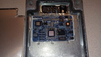

Here's what the internal PCB looks like. The microscopic bridge wires appeared to be both un-insulated by the conformal coating, and possibly touching in several places. There's no "benchtop" repair possible on a board like this. Simply removing the conformal coating would destroy the bridge wires. Why in dog's name did they design something as mission-critical as a transmission control module using such fragile interconnects?
It's been driven for 4 or 5 trips between my house and my mother's and there's nothing wrong with the transmission behavior, and certainly no recalcitrant P0604 DTC (or any DTCs).
I'm somewhat concerned by the potential failure rate of this type of part in an automotive environment.
