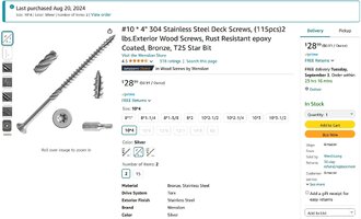

Well... it seemed to take forever to finally locate a Locking Aluminum Grooved Plate that can either be mounted upon the Rear of a Trailer, upon a Truck Tail Gate...or in THIS case... upon the outer portion of the Deck Entranceway leading into the Arrow Shed:
Comme ça ...
So I've ordered One Plate and of course... all of the gear needed to properly install it adjacent the Shed Threshold via Amazon...Thusly:
Since I Try My Best... NEVER To Do ANYTHING "By HALVES"... I took a second look at my Box of 304 S/S T-25 Aluminum Plate Fasteners and opted to search around again for something with a little more "BITE" to them.
These Construction Wood Fasteners are compatible with the 2" X 6" Treated Lumber I used to build my Platform Deck (15' X 11" x 2" X 6" Lumber - 14" On Centers for the Joyce Settings and covered in 3/4" Marine Plywood Decking). Such Fasteners are NEVER CHEAP...
(They Might Tear a Hundred Dollar Bill in HALF for a Full Box)
BUT... if the holes are Pre-Drilled, with a slightly smaller OD and then coating the Screw Thread Lines with a rake across some Bees Wax... then using my Milwaukee M18 Power Tools with the "Makita Impact Grade T-30 TorX Bits", I should be able to Drive home and sink in all 6" of their Length of the 4-6 Sturdy Screws required to ensure that the 60" Long Notched Aluminum Locking Plate will -- NEVER -- Shift or Come Loose with the repeated stresses placed upon the Tri-Fold Ramp ... For as Long as Grass...is GREEN...and Skies are BLUE! :>)

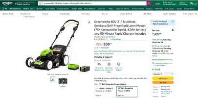

It follows on that by investigating this "In Kind" of Electrically Powered, self-propelled Lawn Mowing Gear... I settled upon getting him THIS Unit:
...and a Canadian's Perspective and Unboxing:

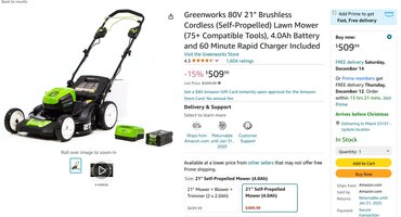

I also opted to include an additional Dual Battery FAST Charger that can Re-Charge BOTH Batteries in 45 Minutes:
...and One Additional 80 Volt DC Battery:
Naturally, after he described the modest size of his back yard and reconsidering the other involved difficulties... this alternate idea greatly appealed to him and he thanked "The Old Man" for getting him out of the Dreaded "Get the Gasoline, Change the Oil, Replace the Spark-Plug and TRY to get it to START..." Routine... We settled on this Gear as the Best and Most Practical Solution... well and truly Clean, and Highly Powered by Reliable 80 Volt DC Batteries.

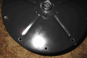

Thankfully there's no odd noises or play involved, but after taking another look at things while it's all taken apart, I think I have a hypothesis to my issue. Do you use the chute on yours? I took mine off and put it up on the shelf and keep the mulching cap on, as the chute makes it too wide to fit in/out of my shed door.
Getting a better look at the shape of the cutting deck, and where the passages are to direct the clippings to where the chute/bagger tube would be, had a :lightbulb: moment. Right behind where the chute goes, is a choke point. Between the caked on clippings, choke point, and new clippings without an exit point, that's probably what's bogging down that side of the action when I hit tall or thick grass, which tends to happen when I'm close to the lake. May try to rig up something with some twine that would allow me to raise the chute as needed to fit the mower through the shed door. :undecided:
I do remember the roller seat mods, not sure I would need that many wheels, although I do have a number of spares that I bought for my Craftsman creeper, so I could do it if I needed to.
No... I have no Plastic Mulching Plug or Plastic Chute Guide attached...and Yes ...I think You're RIGHT... Just an FYI... The Hobart Company (another source for RYOBI Critical Parts) produces an 80 Volt Version of our RELM Gear and right at the neck of that Opening...they've installed ANOTHER small Electric Motor and Turbine mounted in-line that pressurizes the Vacuum Up Tube leading to the Hopper Bins in back and works to the extent that ...No Clipping ever get caught in that "Bottle-Neck". :>)
One of the chute bolts wouldn't grab in its square hole, to let me remove the nut, so I had to get creative. Tried cutting a slit in the head, to get a screw driver into, but it wasn't deep enough to get the right grip, and kept popping out when I ran the impact on the other side, so I ended up having to cut the head off. Fortunately, I had some 13mm bolts and nuts in the tool chest that fit just as well.
Got a little creative with the chute. Drilled a couple of small holes (only needed 1 really) on the end, and grabbed an end-of-life bungee cord. Hooked one hole, and the other end to the seat frame so it was easy to reach and out of the way. That allows me to lift the chute guide as needed so it doesn't get caught on anything and broken off. I thought to wrap the cord around the console, and hook the other end in the 2nd hole, but it turns out the slim gap between the console and the seat is tight enough to wedge the cord and hold just fine. :biggrin:
Since I had the deck apart, went ahead and sharpened the blades again just for the sake of it. This time I also did the mulching area of the blades, which I skipped before. Although the mower was parked in my garage for a week unplugged, I ran it and got the front and side yards done quickly, moved to the back, and got the area right behind the house done, but got the low charge activity when I moved deeper in the back. :mad: This will probably be the last summer for these batteries, will have to make the switch to LiFePo4 before next year. 3 of the 4 current batteries are 7 years old, so I've gotten my money's worth out of them. Will be a bit of a pain if I have to do my property in split shifts, but it is what it is...
It may be the case that in many circumstances, the use of a Ryobi RM480E "RELM" might be either an -=expensive extravagance=- due to having a minimal amount of Yard... or just plain impractical for folks without enclosed Garages or Roomy Sheds.
Nonetheless, whether just a Patch of Grass or an expansive acreage, it all becomes unruly and all will still require a decent cutting and manicure if one enjoys "The Pride of Place" and the need to avoid the scrutiny of Angry Neighbors and-or diligent County Inspectors. So It follows on that after receiving a TXT from my son asking,

This is a design that relies upon a Threaded Bolt with a Thrust Bearing, a Carbon Steel Cutter Insert and a Slightly Over-sized Catch Cup opposing it for squeezing down and miraculously and accurately slicing through the area to be excised out large enough to accommodate the New Electric 48 Voltage and Amperage Gauge Switched Power Meter.
This can only happen by using such a Clam-Shell device that inexorably cuts like a "Cookie Cutter" but with an extremely Sharp and Robust High Carbon Steel half strong enough to punch through 1/8" of Stainless Steel Plate.
Since it is modestly priced, I prefer using THIS method to risking exposure of any part of the Ryobi Electrical Control Panel after being showered with Metal Particles coming as cast-off from the Dremel:
Talk about having "The Proper Tool ...for The Proper Job"... this "Thing" will punch out a 2.42" Hole and be just about the right size opening for our purposes:
