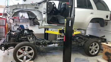

I have a 2007 Trailblazer LT that I have basically rebuilt (performed a body, body harness, and ENTIRE interior swap) with my crashed 2008 SS. So, now it's a "pseudo-SS" I guess.

Also, if anyone has any questions about what the body-swap entailed, please feel free to ask!

You should start a thread on this swap. Sounds interesting. Love to see more pics.
