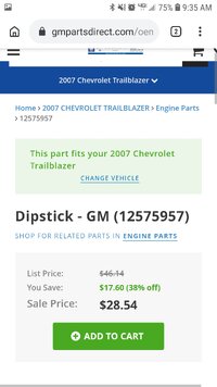

Found this. Try looking that part up elsewhere for better pricing maybe as they have been terrible on shipping in the past.
Geez, for $40+, I think I'm better off just trying to replace the O rings at the top of the stick and hopefully it will go in and out more normally (thats what she said).

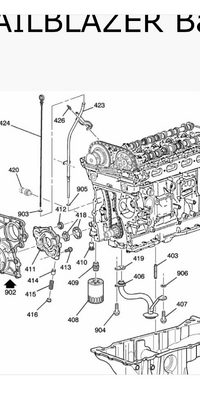

Question: Where exactly is the oil filter? It is between the engine and the oil pan, or between the oil pan and the engine? In other words if little bits of rust do fall into my oil pan, are they going to go through the filter before they get sucked up into the engine?

I would say 'best practices" would dictate removing the tube, #423 in this image, and cleaning it or replacing it.
If I were going to try cleaning it in place I would do so when I was going to be changing the engine oil anyway. I would do so when the engine and oil were fully warmed so things would drain quickly, hopefully taking with the oil much of whatever falls down the tube during the cleaning. I would flush the tube with either a light spray lubricant or maybe Marvel Mystery oil after cleaning the internal rusted top section with a round wire brush of an appropriate size.
As to the circuit of the engine oil it goes from the pan through the oil pickup tube screen (at the bottom of piece #406 above) then up the tube to the oil pump then onward to the filter and finally off to the oil galleries of the block. So any debris that might fall into the pan and oil during the dipstick tube cleaning would first get drawn into the pickup tube screen.
He has the V8.
The filter is located on the left rear of the engine on the oil pan.
