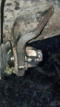

Oh. My. Goodness. I have done everything, Dremel, nut splitter, torch, hammer and chisel, nothing will get this nut off of the link. It's stripped from within the link so when I turn it, it turns the bolt inside the link as well.. Any ideas? 2 hr job turned into 6 so far and I'm still on the first nut:banghead::banghead::banghead:

Ugh it doesn't fit. I literally torched it till the whole thing was red hot then I made two cuts on opposite sides and it still won't come off.

Thanks for the suggestions, I used vice grips to stop it from spinning which actually allowed me to chisel the nut in two. Yes they are stock, but at the end if the bolt, I was so rusted that I couldn't even get an Allen in there to hold it... I even used a hammer to try and hammer it into the end with no avail lol. But yes, I will be doing the rest of them with vice grips and lots of PB blaster
