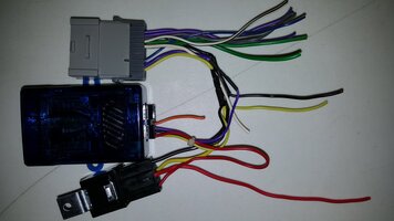

This is the interface I kept that was with the Sony single din stereo that I sold.
Would this Scosche interface be useful for most aftermarket stereos to use in the Envoy & would it keep the things that i want? We don't need the XM.

It should work but Scosche is not a reliable brand. Have heard of these screwing up the CanBus on occasion.
The grey plus is? the small black plug is? i think the grey plug is speakers, small black would be? Do i tap into the small black plug?
How would I hook up the scosche interface with unknown Double bin stereo wires.
There's an orange cut wire coming from the Scosche. Do i hook orange wire from Scoche to unknow DD orange "illuminate" wire?

Scosche GM09SR 200-Up GM interface
Scosche wiring codes from the net.
