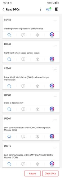

I know this thread is super old but I finally got the time to replace the steering wheel position sensor... well after doing so, the traction control and repair light come on every single time I turn the car on, almost like I either got a bad one out of the box, or wiring on it went after I replaced it?

While I have yet to try anything yet because of the massive snow storm, I have done some research about the installation of the sensor. Apparently you arent allowed to move the wheel at all when installing same with the sensor itself and I remember taking out that pin before install because no instructions of course but also no video said not to. So after taking off the old one you have to keep the wheel at 0 degrees and remove the pin on the sensor after installation of everything. So im going to try and reinstall a new one first using that procedure, then try all the diagnostics above, thank you.
If that fails, as per indicated higher in this thread, you may need to update and calibrate the EBCM.
You need an adapter, like a J2534 pass-through, that can program modules. On your 06, you should be able to use a Tech 2 and a laptop loaded with the Tis2000 software. A J2534 alone, you could use the ACDelco TDS system with a subscription.
Wow, so 200 just to reprogram a stupid steering angle sensor that wasnt even necessary to replace, I hate this vehicle😂
You think a shop would charge around the same price?
How hard is that to do, finally got the time to put a new one in, pulled the pin after full installation and still showing up as soon as I turn the wheel
sorry if this is dumb... but a couple post back you posted some install procedures which indicate the steering had to be in "0" position.... how did you determine that at the time of the removal of the original unit?

So i ended up getting it just to try it out because it was 1 day shipping and they wouldnt respond to my email.
Anyway, unfortunately recalibration is not supported on my vehicle, but I did read up on a couple of the code that they listed, including my p0171 issue.
They state that the mixture between fuel and air is monitored by the ecm. Then when I look at these codes, it mentioned ecm connection failure. What are your thoughts?
p0171 is not related to this thread. If you want to look into it, you will need to start a new thread. But I would fix the rest below first as this may be a simple fix.
C0040 is a common error that will inhibit Stabilitrak and ABS. It could be the reason for the C0244. Fix the sensor issue first but diagnose it properly. Check live data to see what speed you are getting at all the sensors. The most likely problem is a wheel hub going bad or a bad/cheap new hub. As it gets worn close to the point of failure, the tone ring inside gives false readings to the sensor. On older trucks, this would give an ABS activation when coming to a normal stop. Another possibility is rust jacking under the sensor. They added a new code (maybe the C0244) to prevent that unwanted ABS activation but the wheel hub or sensor is going bad.
U1300, U1064, U1016 is bad. That means the whole network is down and IIRC, means it is shorted to ground. The BCM is unable to communicate with the PCM on the normal network however they have a backup network. Is anything else not working? If the Class 2 network goes down, a lot of stuff won't work. A lot of diagnosing to try and fix this and may be beyond the scope of this thread. Ran it by AI and got this:
Codes U1300, U1064, and U1016 on a Chevy indicate a communication failure on the Class 2 serial bus between modules, often involving the Body Control Module (BCM), PCM, or instrument panel. These are frequently caused by low battery voltage, poor ground connections, or a shorted module.Common Causes & SolutionsBattery/Charging System: Low voltage can trigger these codes. Check for 12.8V+ at rest and 14V+ while charging.Ground Connections: Check the main ground wires on the back of the engine and the BCM ground, as corrosion here is a common cause for multiple, seemingly unrelated U-codes.Module Communication (U1016/U1064): These indicate the BCM or instrument cluster is not receiving data from the engine/powertrain module. Inspect the harness for corrosion.Class 2 Circuit Short (U1300): Indicates a malfunction in the network wiring itself, often causing the system to go down. Troubleshooting Steps
  1. Clear Codes & Reset: Clear all codes with a scan tool and perform a full system reset by disconnecting the battery for 10–15 minutes.
  2. Check Grounds: Clean ground points on the engine block and near the battery.
  3. Inspect Fuses: Check the "RDO1" (Radio) fuse and other electronics-related fuses in the underhood block.
  4. Module Test: If codes return, test for a short in the network by disconnecting modules one by one (using a splice pack if equipped) to identify which one is pulling down the data line.
Well, sort of. The early years do have have a secondary circuit that bypasses the SP205 splice pack and runs between the PCM and BCM. However, I have traced the two different circuits on a BCM card and discovered that almost immediately upon entering the circuit board the two wires are joined together by a trace on the board. So anything that takes down the primary circuit will aslo take down this redundant circuit as well.
I have wondered why they bothered with this secondary circuit. Maybe it had to do with diagnostics procedures that involved removing the SP205 splice pack comb? The redundant circuit would then retain PCM/BCM communication. Unless there is an electrical issue like a short to voltage or ground.
