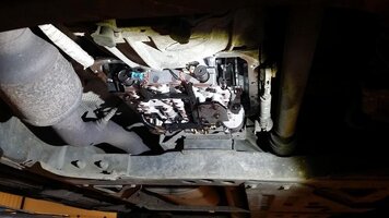

Ok so while the TB is thawing I thought I'll give you guys a sneak preview on today event with my TB.
Replace trans fluid and filter, the nice part of working in a shop is that you have both style filter if you don't know which one is installed.

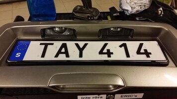

Replacing license plate bulb harness
Installing new license plate cover glass

Transmission done, as you can see on the pictures. You should get one of those rechargeable LED lights that are in the picture, those are awesome lights.
Factory transmissions have a thin square magnet inside the pan, I found a TSB were they say that you should replace the square magnet with 2 round ones. I only had 1 round one at the shop so I thought I'll use the square one instead of another round one. I put the square one on the opposite side from factory marking and the round one inside the square marking on the pan. The reason is that on the RH side there is not much room between the pan and the filter so I'm not sure the thicker round magnet would fit on that side (the thin magnet is thin enough to fit between the filter and pan).
Finally install the new gasket and secure it with 4 bolts and you'r ready to install the pan. Of course I put a new filter on it first but got no picture of that.

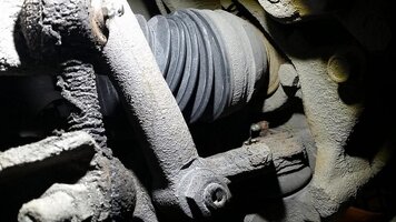

Check point more stuff, greased front end - well the few fitting I could find.

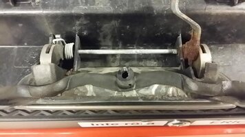

Replaced license plate wire harness due to one bulb socket was corroded to beyond repair. New harness, new covers and nice new screws.
One "what ever it's called" broke when removed but we have special glue for plastic here at work so I fixed it.
