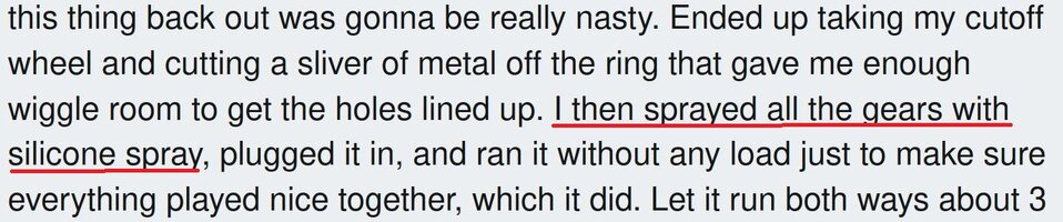

Today, decided to go ahead and get that spindle swapped out. Didn't go nearly as well as I planned it to. From YT videos, I knew the mounting holes were not threaded. So I took my impact, and drove the original screws through the holes to thread them for me.
Went to drop the spindle in place, and it wouldn't set into the lower bushing. OEM one slid out without much effort. First thought was it had a slightly different manufacturing spec, so use the one that came with it. Quick bench test, and the new one slid into the new bushing with a little bit of force. OK, let's take the old one out... It wouldn't budge. Tapped the underside with a hammer, no dice. :undecided: Grabbed my big C clamp, and an impact socket, and used that to press the bushing out, a la ball joint replacement.
The joke was on me though, because then the new bushing didn't want to go in easily either. Hit it with some silicone spray, used some different sockets and had to press the new bushing in. Pain in the ass. And then on top of that, the new spindle didn't want to slide in. Ended up having to rig up some pieces of angle aluminum to brace on the underside of the plate next to the motor, since you couldn't fit anything on all sides of where the bushing came down, and then press the new spindle into place.
One thing that I noticed, but didn't address, was the OEM spindle has a slight bend on the edge of the ring where it meets the back edge of the opener body, as there's a lip of metal that bends upwards. The aftermarket one doesn't have this, so when you drop it in place, all of the holes are offset ever so slightly. :mad:
Honestly that worried me, cuz if something wasn't right (like this), getting this thing back out was gonna be really nasty. Ended up taking my cutoff wheel and cutting a sliver of metal off the ring that gave me enough wiggle room to get the holes lined up. I then sprayed all the gears with silicone spray, plugged it in, and ran it without any load just to make sure everything played nice together, which it did. Let it run both ways about 3 full cycles, before putting the chain back on, glopping grease all over all the gears, and running it again with just the chain. Smooth travel, a soft hum, no signs of any misalignment.
At this point, 2 hours had gone by, and I was much more sweaty than I planned since I had to keep going back and forth to my tool chest for things to work around the issues. Word of advise for anyone else doing this for the first time, don't try to replace the parts while still mounted to the ceiling. It's annoying and awkward. Just take the thing down and put it on your bench, or on top of your garbage bin (like I did) so you can maneuver stuff around. I probably would have saved a lot of time if I took it down in the first place. :twocents:
Since I was mildly irritated and a sweaty mess, decided to go ahead and disassemble the torsion assembly on the door. The drums wanted to fight a little bit to slip loose, and the bar acted like it didn't want to slide out of the brackets, but eventually let go. So the old spring is out, and all the tools I'll need to get the new set in are ready to go. Hopefully get to pick up the new torsion springs tomorrow or the next day. 🤞

Finished the job after work today. Got everything up without much fuss, wound the springs, and weighed the door. Came in at around 10 pounds, not bad. Gave each spring another full turn, and got it down to about 7 pounds. Didn't want to go any further than that, would prefer to have the springs with zero tension when the door is open. Was able to lift the door with little effort, and it held it's position at several increments up to the halfway mark. Any higher than that, and the springs would take the door all the way up.
Latched the trolley to the door and gave it a trial run. Upper limit stayed the same, but with the considerable weight reduction, here's where the door stopped on the way down :laugh:
At this point I was quite thankful to have the keychain remote, so I tinkered with the downward travel adjustment bit by bit until the door closed completely. Good timing too, as a thunderstorm was starting to roll in. Put the light bulbs in, cover back on the unit, and put the EXT back where it belonged. Mod bug should be content for a while.
